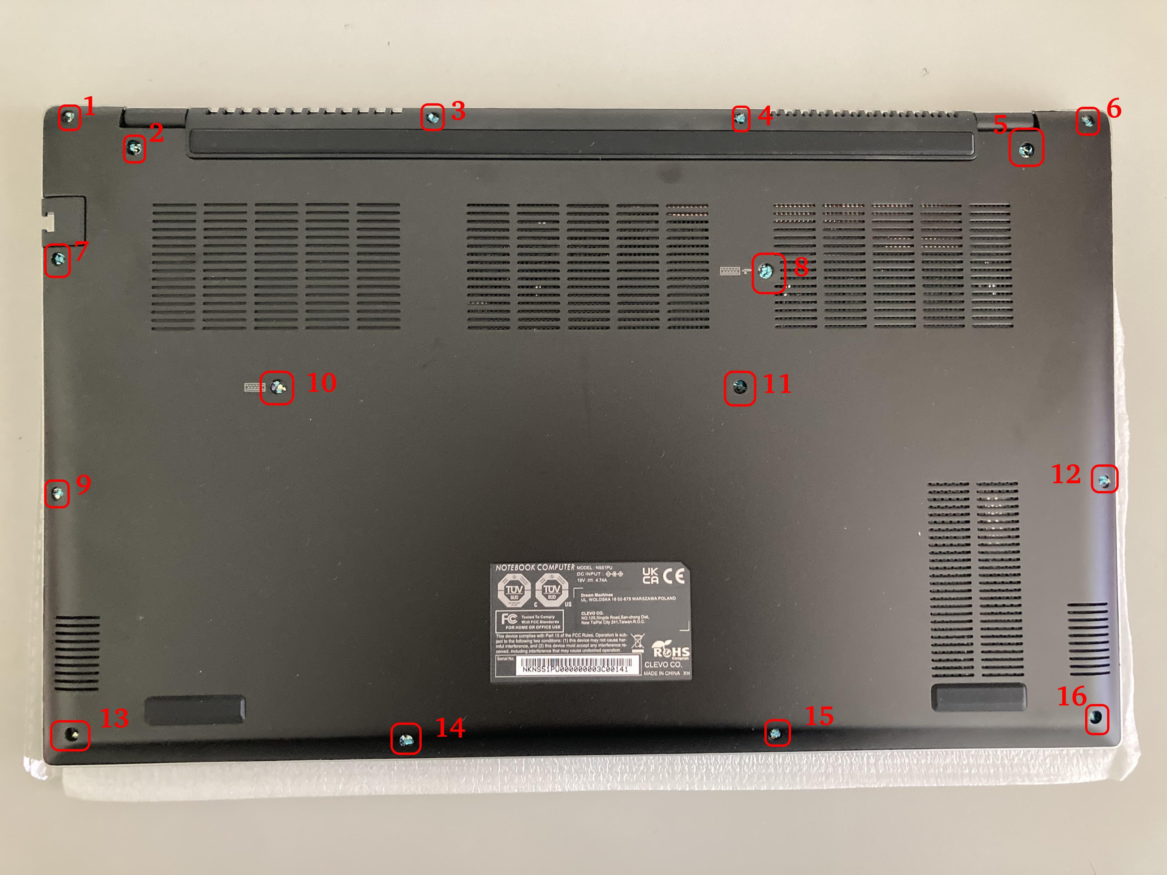

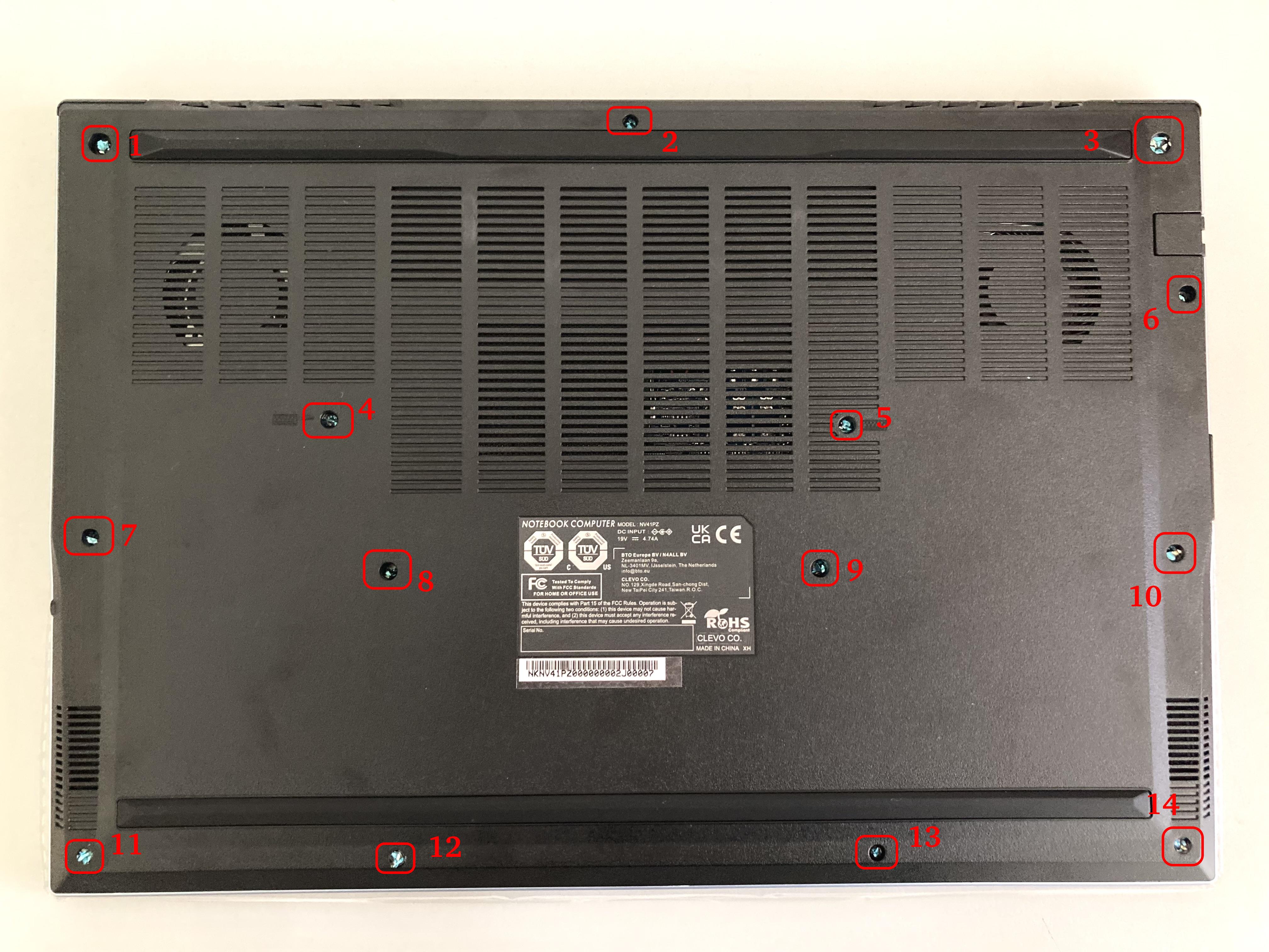

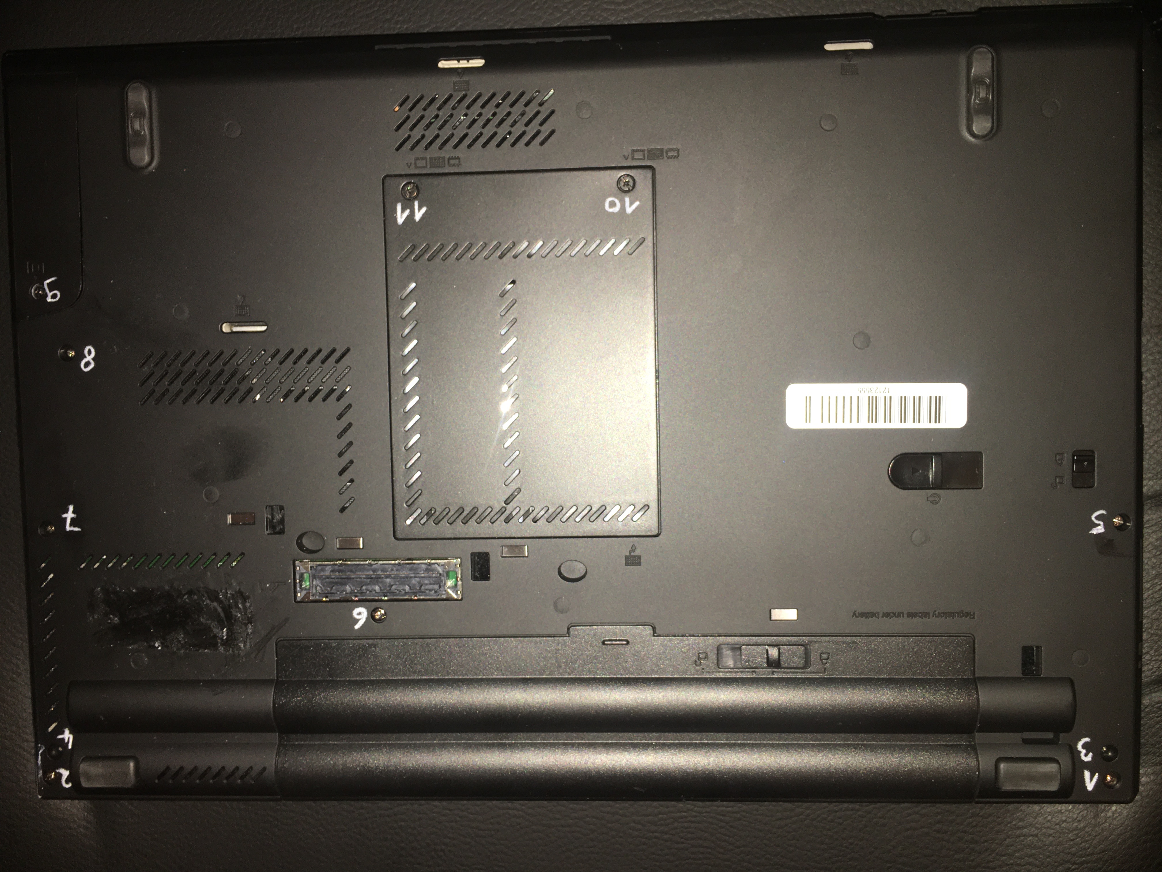

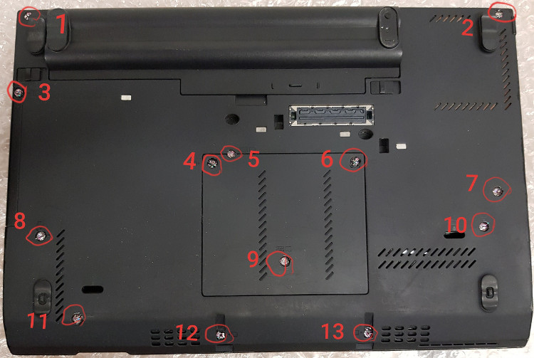

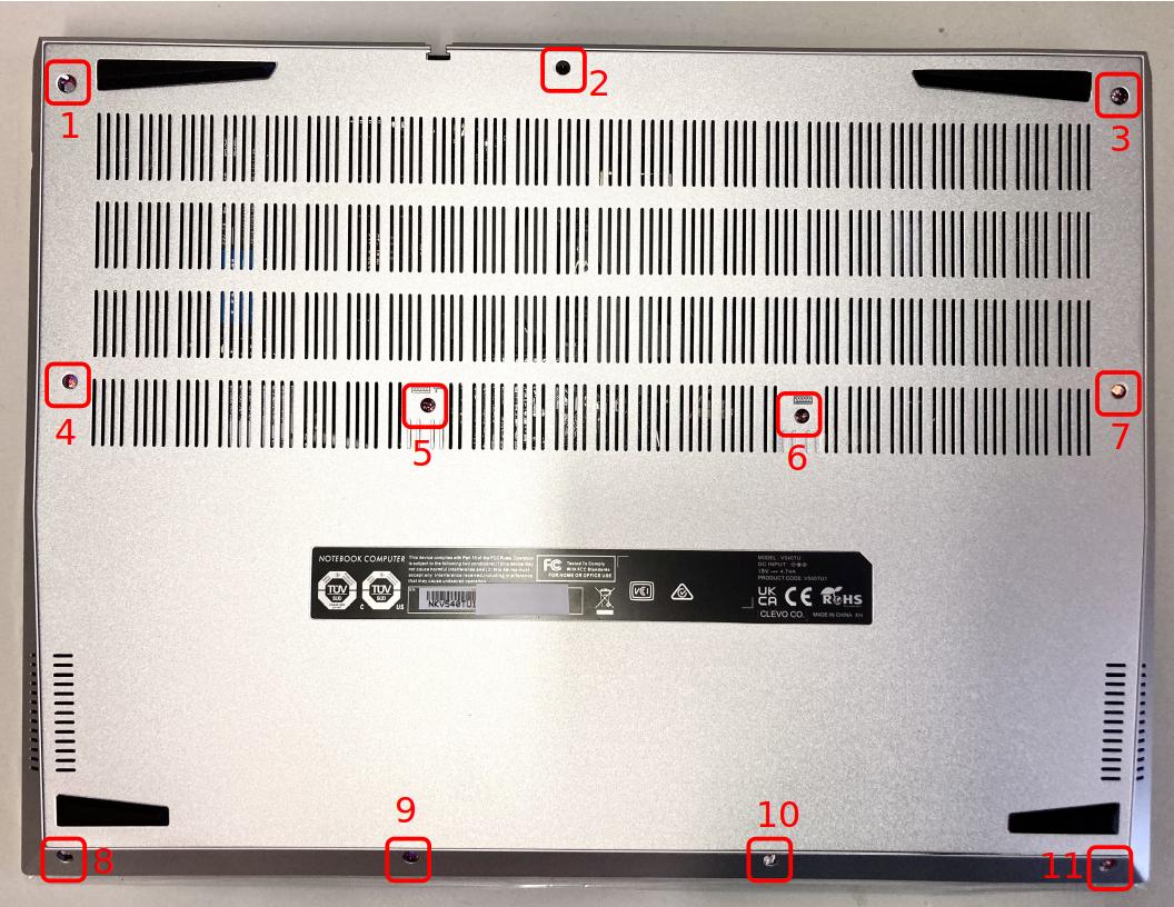

The bag and all screws on the bottom of the device have been sealed. For the bag and each of these screws you have received a photo by e-mail. The orientation of the photos is such that the battery is on top.
Check each screw individually to see if its individual appearance matches the photo. It is best to use a magnifying glass or macro lens for this purpose. The screws are numbered as follows.
Nitropad NV41:
Nitropad NS50:
Nitropad V54:
NitroPad X230:
NitroPad T430:

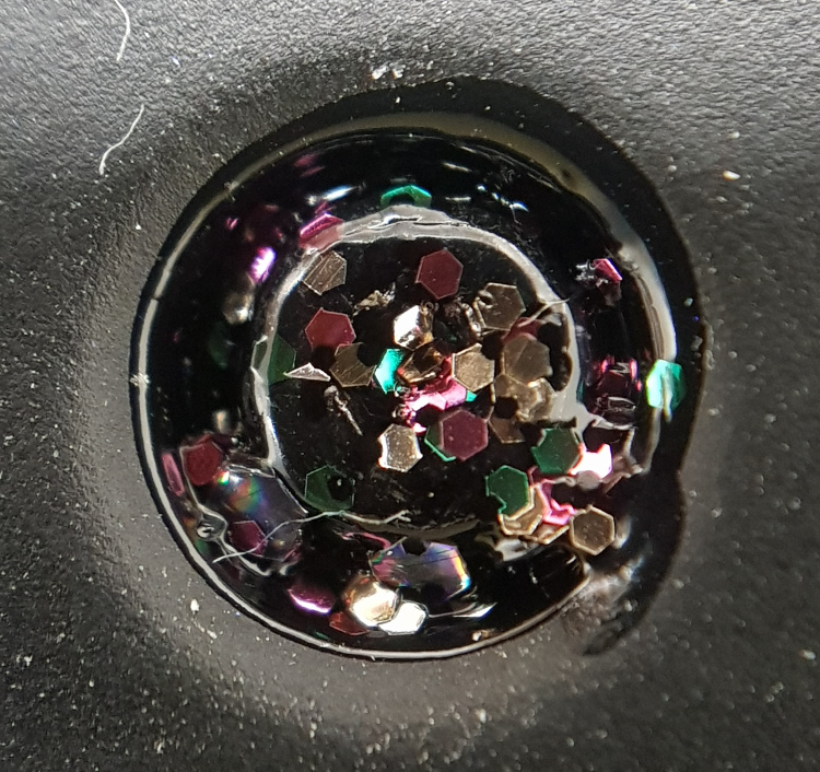

This example shows a sealed screw whose glitter represents an individual pattern.
