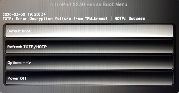

Default Boot¶
If you have installed a new operating system, it may be that default boot is not yet assigned. If this is the case, please proceed as described below.
Select “Default boot”.
Heads informs you that it does not yet know any default. First you agree to the update of the checksums.
